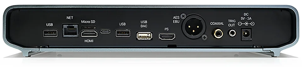

Connections
From your network to your DAC
Stream over Gigabit Ethernet or dual-band Wi-Fi, or play from a USB drive. On the back, I2S and video each have their own HDMI connector.
The back of Rivo+, labelled from left: USB, NET, Micro SD, HDMI, a USB-C port, USB, USB DAC, I2S, AES EBU, COAXIAL, TRIG OUT and DC 5V-3A.
In
Ethernet
Gigabit, 10/100/1000
Wi-Fi
802.11a/b/g/n/ac, 2.4 and 5 GHz
USB-A × 2
Flash drives, HDD and SSD, on one USB 2.0 and one USB 3.0 port
Power
5 V DC / 3 A, on a 5.5 × 2.1 mm barrel jack
Out
USB DAC
USB-A 2.0 with power filtering
I2S
HDMI connector with adjustable pinout routing
AES/EBU
XLR connector, fed by the dedicated ASIC
Coaxial
S/PDIF on RCA, fed by the dedicated ASIC
HDMI
Mirrors the Volumio app on your TV, up to 4K at 60 fps
Trigger
12 V on a 3.5 mm jack, positive on tip
