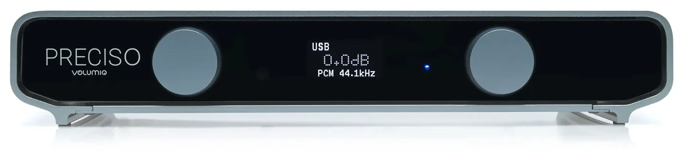

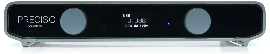

Volumio Preciso from the front: a black front panel with the Preciso name, two grey knobs and a small display that reads USB, 0.0dB and PCM 44.1kHz, in a dark grey case.

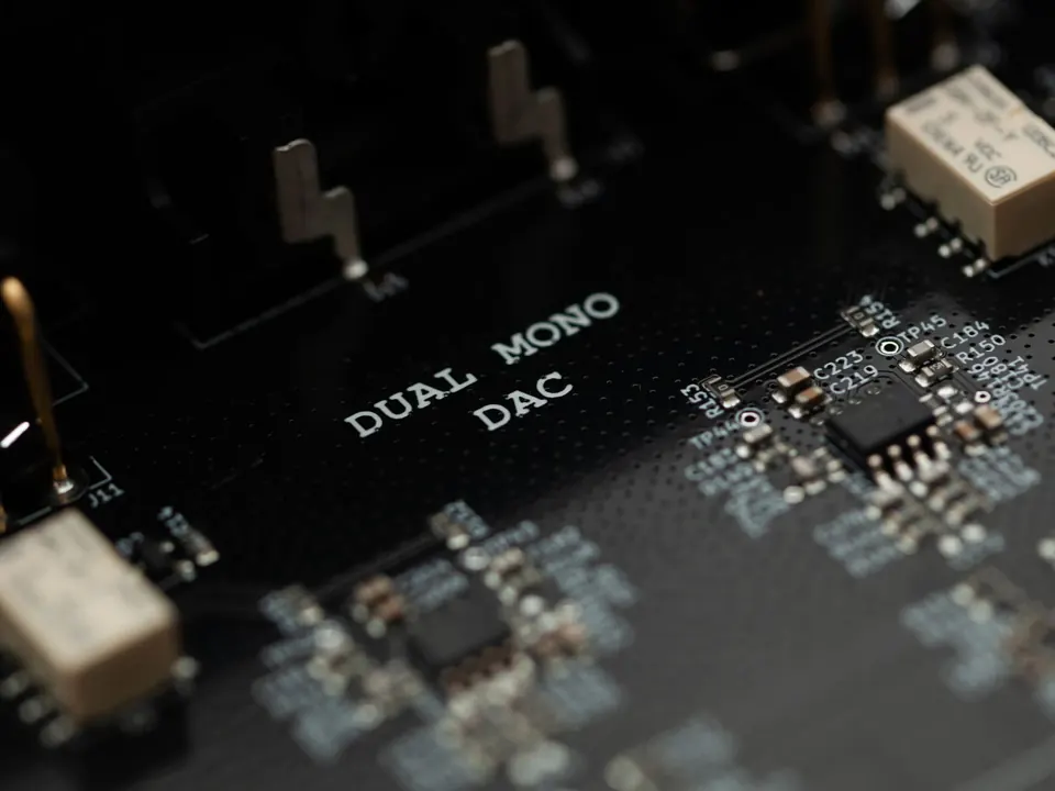

A close-up of the Preciso circuit board, with DUAL MONO DAC printed on it next to a chip.
Dual mono DACs
Two ESS ES9039Q2M DACs sit in mirrored, isolated circuits, one for each channel. The channels stay separate, crosstalk stays very low, and each DAC gets an optimized signal path.

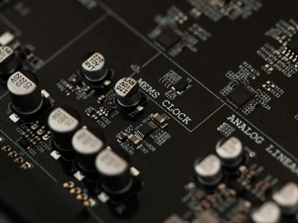

A close-up of the Preciso circuit board, with MEMS CLOCK and ANALOG LINEAR PSU printed between capacitors and chips.
Dual linear power
A dual linear power supply, with LC filtering and dedicated regulators, feeds the analog and digital paths separately. This reduces interference, keeps noise out of the signal and improves dynamic range.

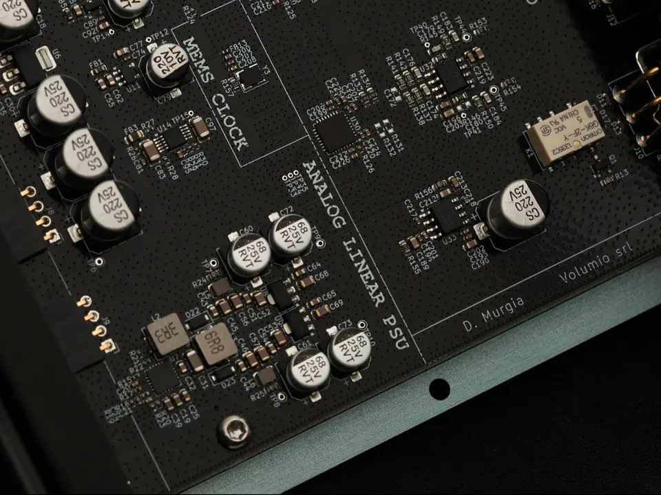

The Preciso circuit board seen at an angle, with MEMS CLOCK printed between rows of capacitors.
Parts where they count
A precision MEMS clock, premium op-amps for the analog stage and a dedicated ASIC for the USB input keep the performance clean and stable.

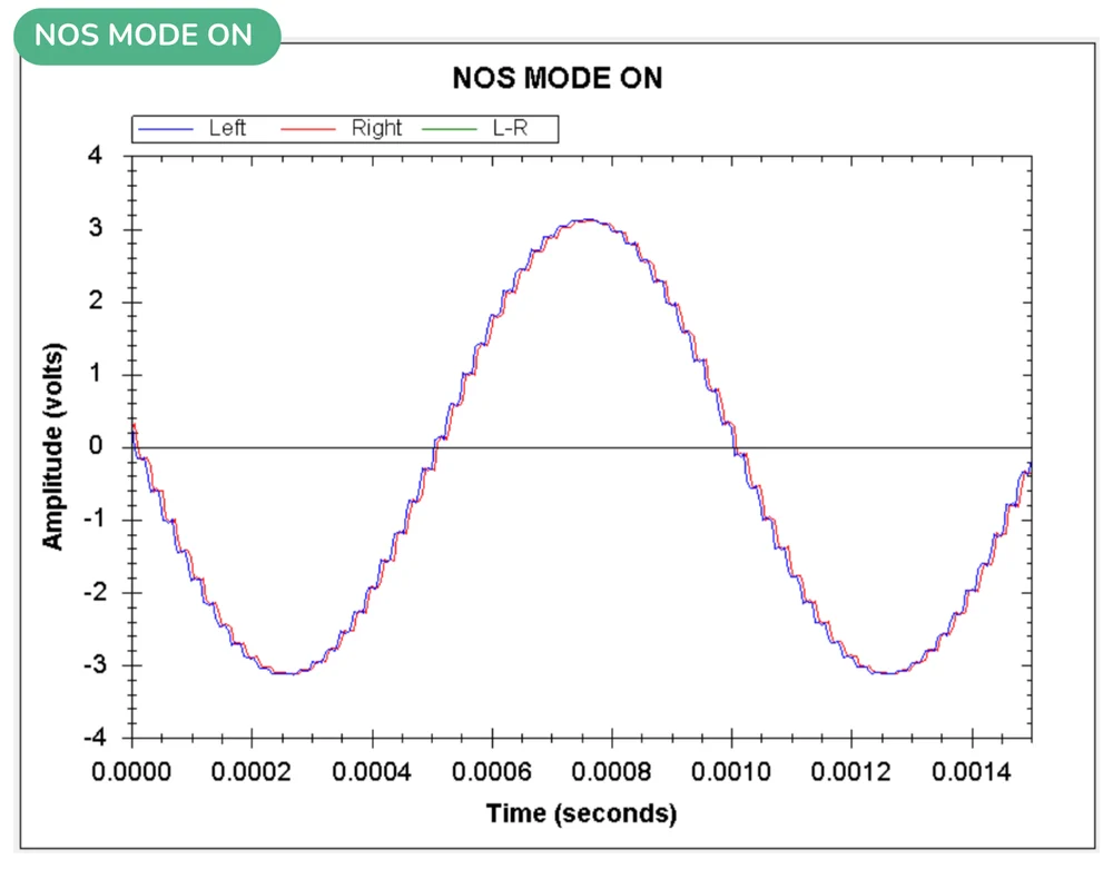

Pick one of eight digital filters to fine-tune the sound. Or turn on NOS mode, a feature many listeners asked for. It switches oversampling off and passes on a raw, unprocessed signal.
Chart with NOS mode off: a smooth sine wave on the left and right channels, peaking at about 3 volts.Chart with NOS mode on: the same sine wave, drawn as a series of small steps.
The output with NOS mode off and on: left and right channels, amplitude in volts over 1.5 ms. Charts from the Preciso shop page.

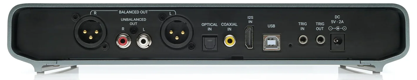

The back of Preciso, labelled from left: BALANCED OUT R and L on two XLR sockets, with UNBALANCED OUT R and L on two RCA sockets between them, then OPTICAL IN, COAXIAL IN, I2S IN on an HDMI socket, USB, TRIG IN, TRIG OUT and DC 5V - 2A.

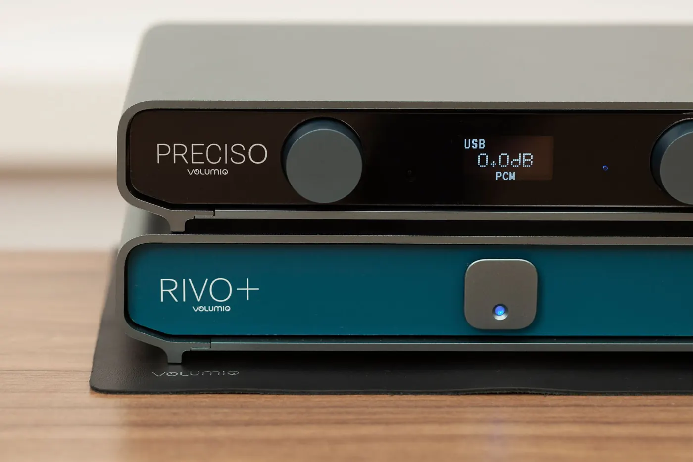

Preciso stacked on top of a Rivo+ with a blue front, on a black mat on a wooden table. The Preciso display reads USB, 0.0dB and PCM.
Rivo+, Rivo or any transport
Paired with Rivo+, Rivo or any dedicated transport, Preciso completes an optimized digital chain. It can also work as a preamp and connect straight to power amplifiers.

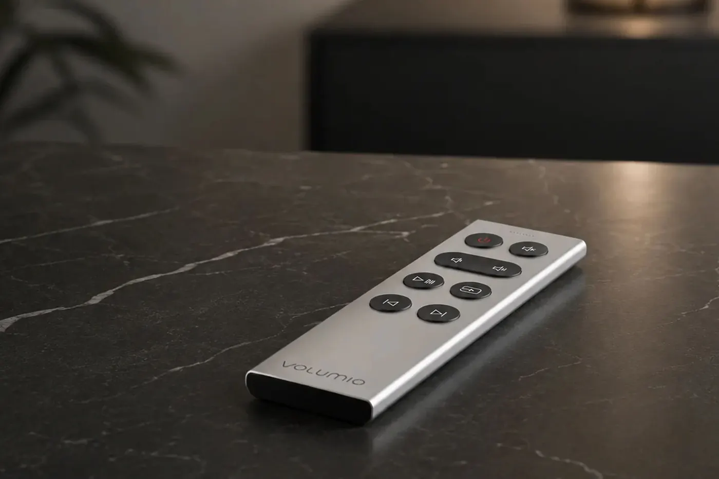

Remoto, a slim silver aluminum remote with black buttons and the Volumio name, on a dark stone table.
Remoto
Remoto is the Volumio infrared remote. Use it to change the volume, the input and the DAC filter, with no app and no pairing. It is machined from solid aluminum, with a silver anodized finish, to complement Preciso.
Remoto is available as an accessory.
