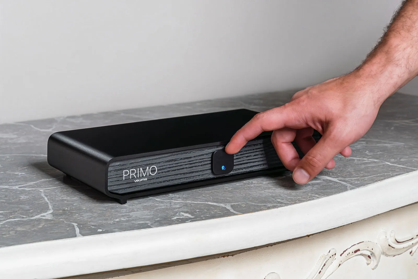

Volumio Primo V3 seen from the front left: a black case with a wood-textured front, the Primo name and a square button with a blue light.

A hand reaching for the button on the front of Primo V3, which sits on a grey marble top.

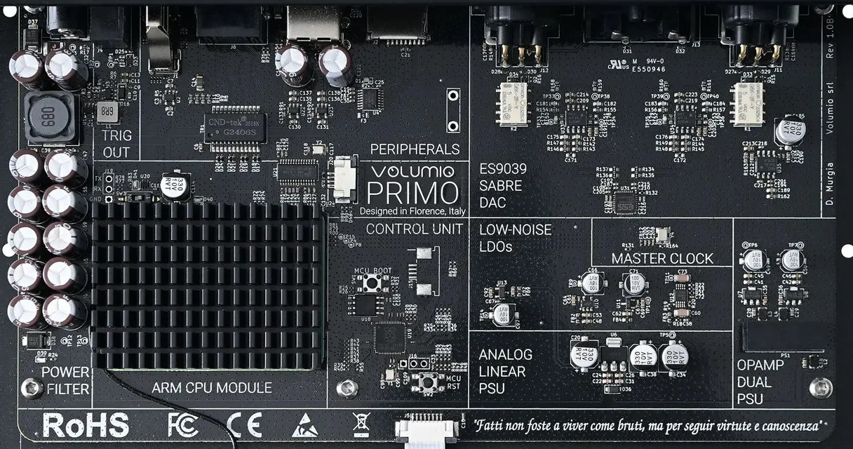

Look inside
Engineered for sound
Primo V3 is a complete redesign of the original Primo. A linear power supply stage and a high-precision clock keep noise and jitter low, and the layout keeps every current path short. Along the edge sits a hidden nod to Florence. Pick a part to find it on the board.
The Primo V3 main board, with each section named on the board: ARM CPU module, control unit, peripherals, ES9039 Sabre DAC, low-noise LDOs, master clock, analog linear PSU, op-amp dual PSU, trigger out and power filter. A line of Italian verse runs along the bottom edge.

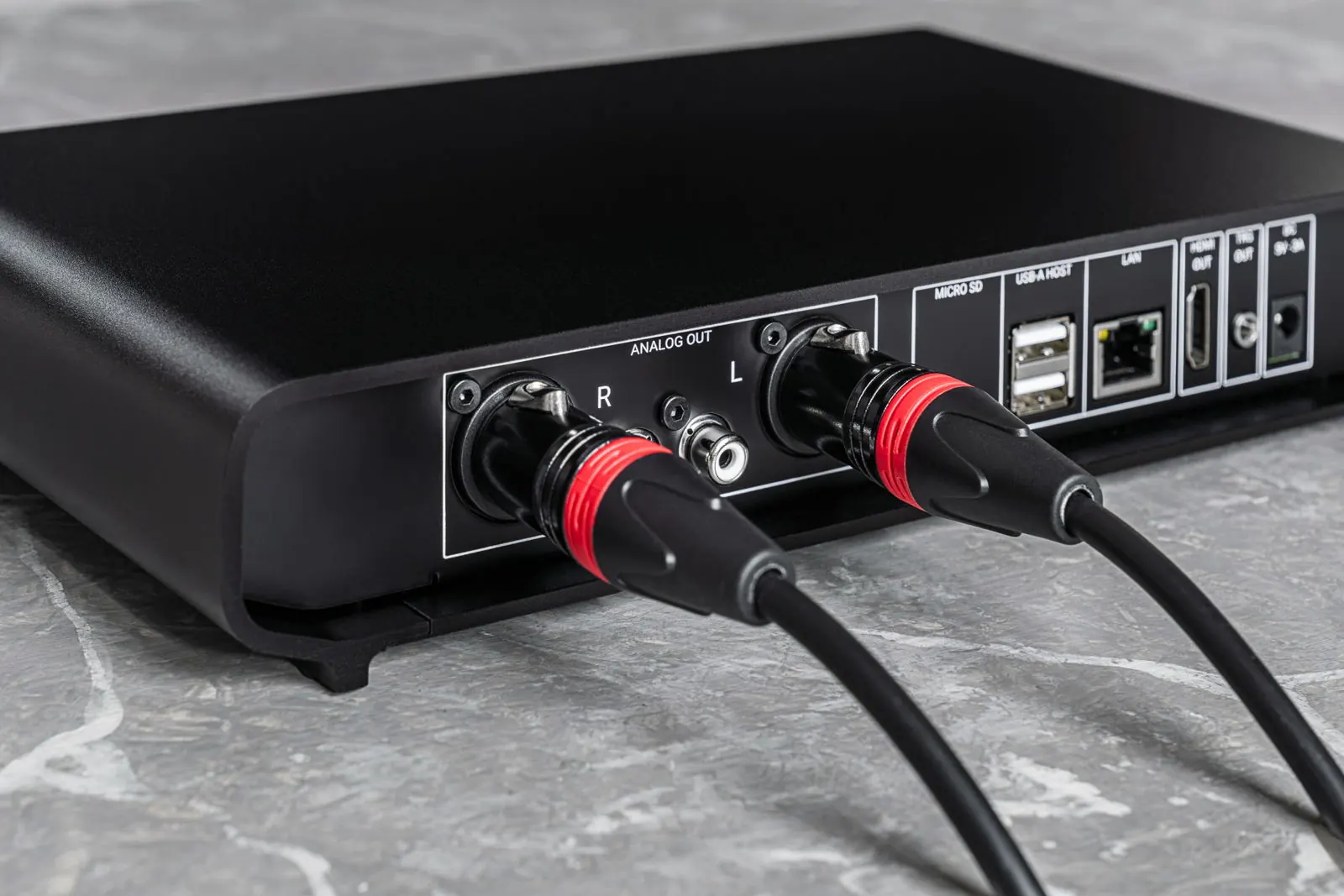

The back of Primo V3 on a marble top, with balanced XLR cables plugged in.

Out
Balanced
XLR, 1.00 to 6.30 Vrms in 8 levels
Unbalanced
RCA, 0.50 to 3.15 Vrms in 8 levels
USB-A × 2
To a USB DAC, up to PCM 1536 kHz / 32-bit and DSD1024, with multiroom off
HDMI
Mirrors the Volumio app on your TV, up to 4K at 60 fps

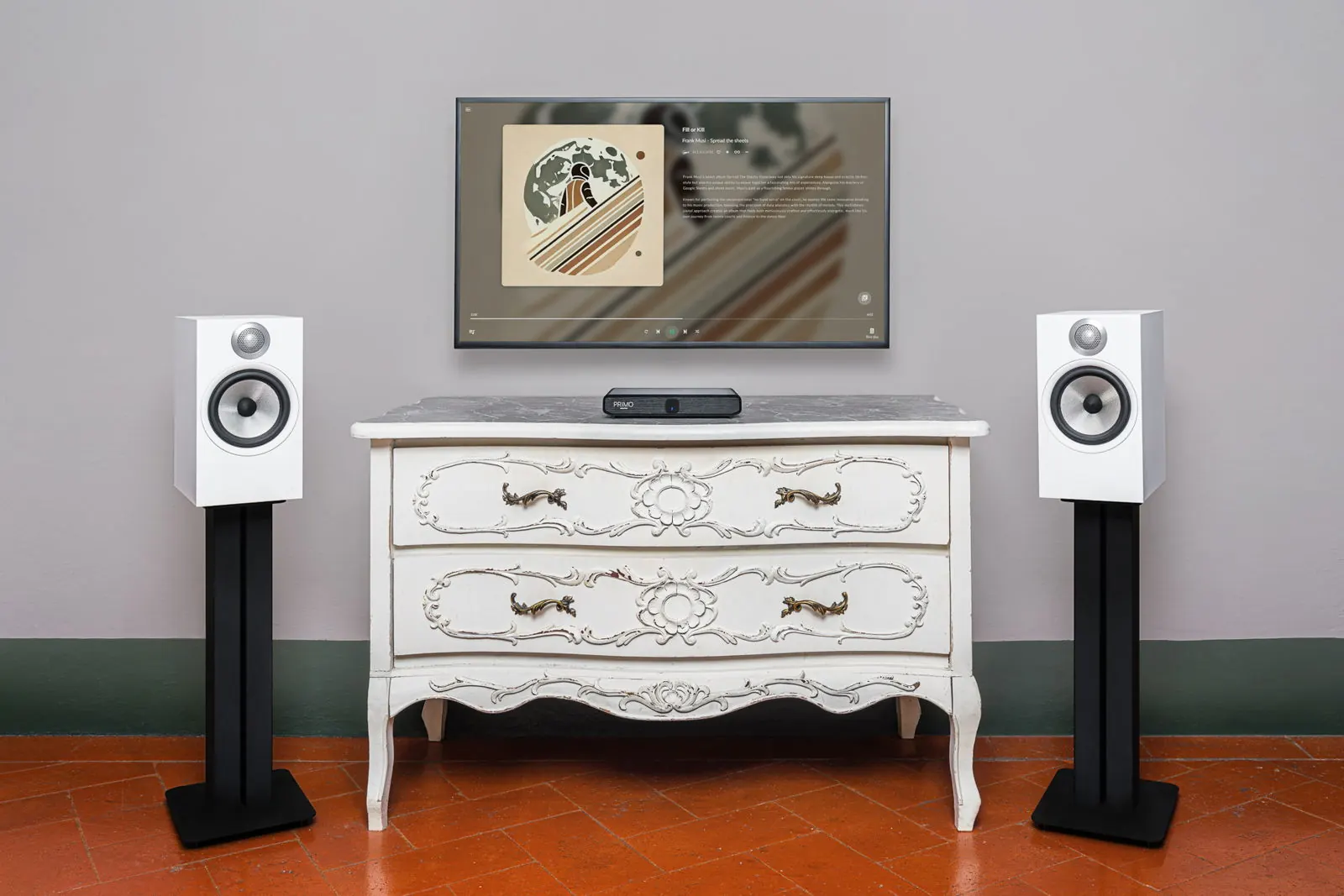

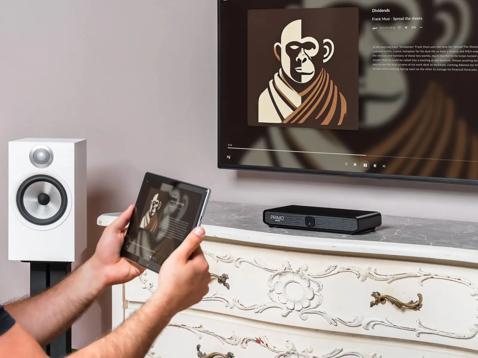

A living room with a TV on the wall showing album art, two white speakers on stands and Primo V3 on a white carved dresser.
On your TV
Connect HDMI and browse your music on the big screen, in up to 4K at 60 fps. Nova, the new Volumio interface, is in beta and on its way.
Discover Nova
A listener holding a tablet that shows album art, with Primo V3 on a dresser and the same album on the TV above it.
In your hand
Browse, play and control it all from the Volumio app, in lossless and high resolution.
