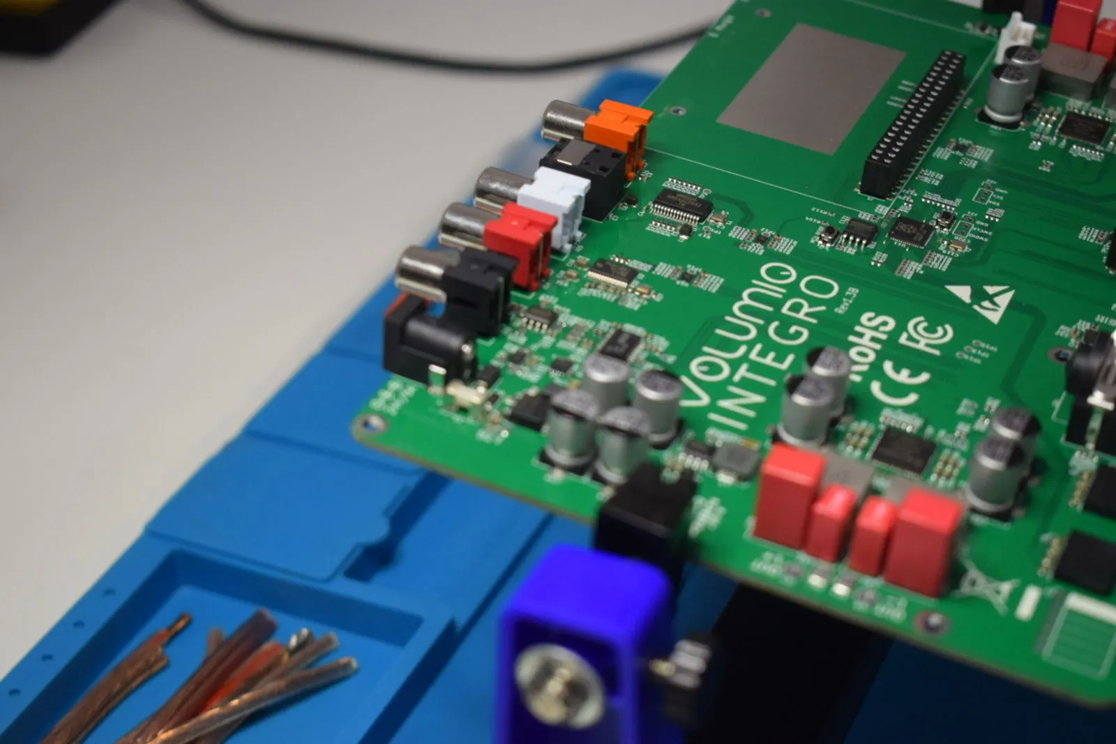

Two amplifiers. One per channel.
Integro uses direct-digital Class-D amplification in a dual mono design, specially tuned for it. All the parts fit in one compact case, so all you add is a pair of speakers.
A close-up of the Integro circuit board, printed with the Volumio Integro name, on a blue work mat.
Dual mono Class-D
Two Infineon MA12070P amplifiers run in a dual mono configuration, in PBTL mode. Each one drives one channel.
The output stage
The output stage uses WIMA polypropylene capacitors and inductors with a high saturation current.

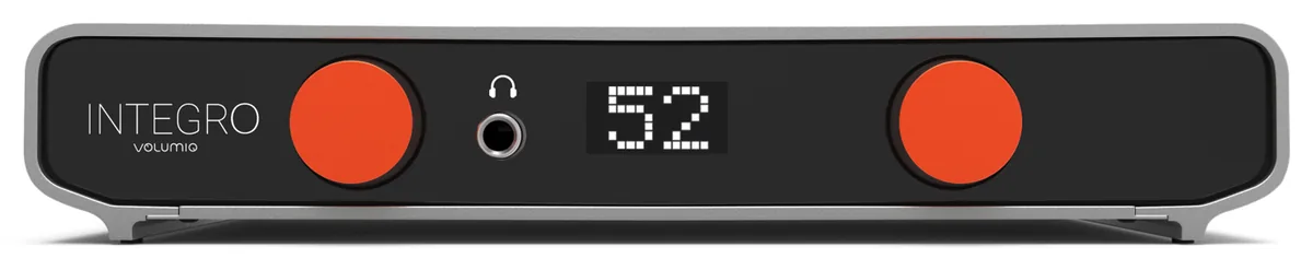

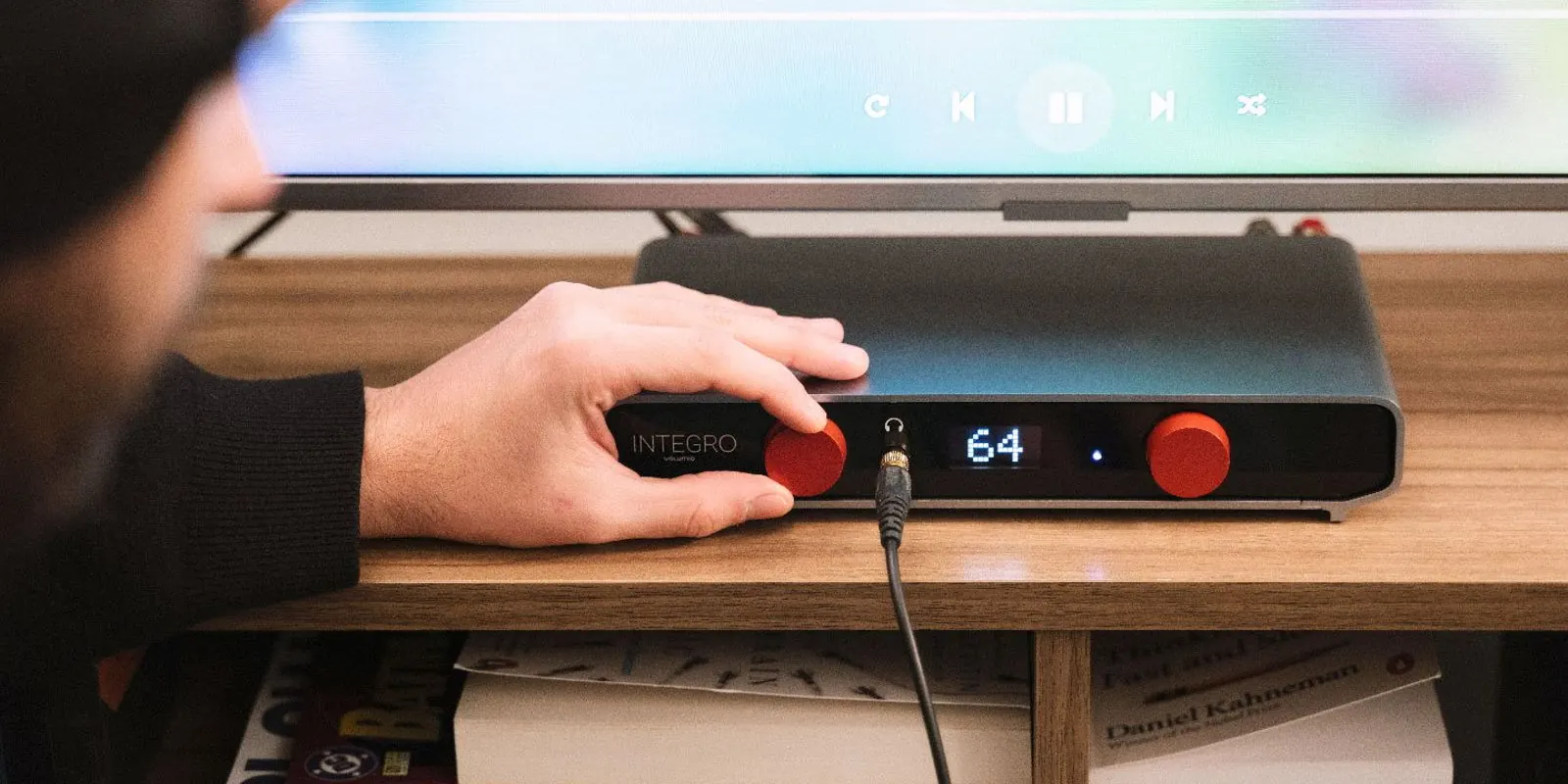

For your headphones
Plug them into the 6.3 mm jack on the front, and Integro detects them. A Texas Instruments PCM5122 DAC and TPA6120A2 amplifier drive the jack. Up to 480 mW per channel into 32 Ω, and 300 mW RMS into 64 Ω.
Output power per channel, in milliwatts
64 Ω
300 mW
32 Ω
480 mW
A listener turns a knob on Integro, with a headphone cable plugged into the front and a TV showing playback controls behind it.
The headphone jack sits on the front, between the two knobs.

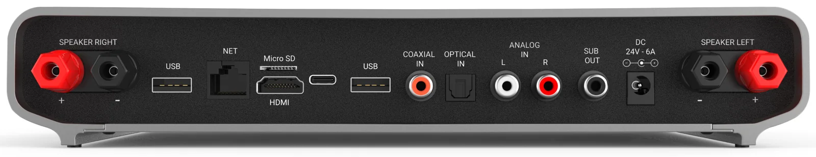

Connections
Stream it, or plug it in
Stream over Gigabit Ethernet, Wi-Fi or Bluetooth. Or connect a source to the analog, coaxial or optical input. Add a subwoofer, and connect a TV over HDMI for the Volumio on-screen menu.
The back of Integro, labelled from left: SPEAKER RIGHT with red and black binding posts, USB, NET, Micro SD, HDMI, a USB-C port, USB, COAXIAL IN, OPTICAL IN, ANALOG IN L and R, SUB OUT, DC 24V - 6A and SPEAKER LEFT.
In
Network
Gigabit Ethernet, or Wi-Fi 802.11a/b/g/n/ac with 2×2 MIMO
Bluetooth
5.0, with aptX and aptX Low Latency
Analog
Stereo RCA, converted at up to 192 kHz / 24-bit
Coaxial and optical
S/PDIF on RCA and TOSLINK, up to 192 kHz / 24-bit
USB × 2
One USB 3.0 and one USB 2.0 port
Power
24 V DC, 6 A
Out
Speakers
Left and right, 2 × 70 W RMS into 4 Ω or 2 × 50 W RMS into 8 Ω
Headphones
6.3 mm jack on the front, with insertion detection
Subwoofer
Mono RCA, 2 Vrms
HDMI
The Volumio on-screen menu on your TV

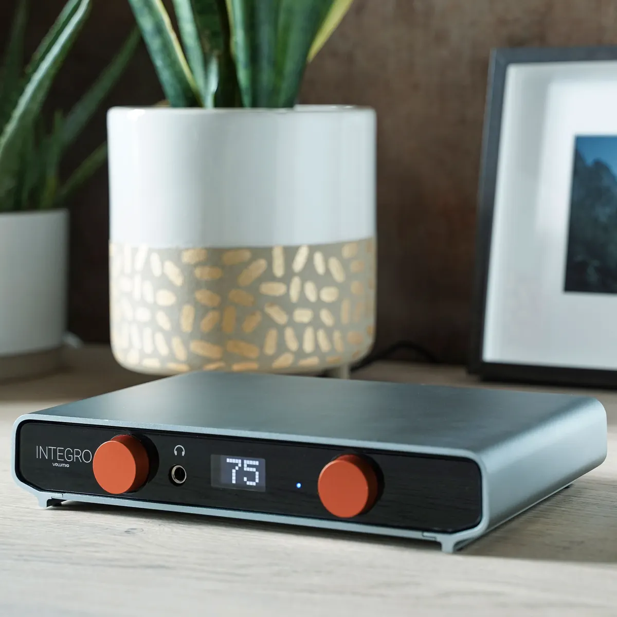

Design
Designed with Design Narratives
Integro was designed with Design Narratives, a Red Dot Award winner. The electronics sit in a compact chassis of antimagnetic aluminum. Two orange knobs control the volume and the inputs, next to an OLED display.
